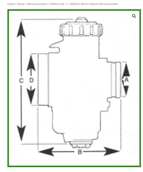

Pour info:
VM 36-4 neuf
Pilot jet 35 (VM22/210), Needle 6FJ6, Needle Jet Q-5 (159 Series), Main Jet 310 (4/042), Air Jet 2.0, Slide Cutaway 2.5 (VM36/36), Needle valve 3.3 (VM34/39)
Mikuni VM36-4 Dimension A= 43mm, B= 116mm, C= 152mm, D= 62mm, Total Width= 79mm
