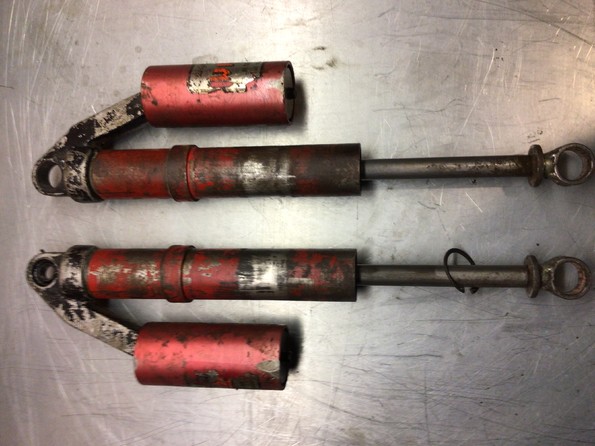

Voilà la messe est dite: si vous voulez sauver vos amortisseurs il faut vérifier que vos corps soient compatibles avec des pièces détachées disponibles en diamètre 12mm...
Trouver un réparateur qui veuille bien se lancer dans la réfection et qui aura les compétences pour faire du sûr mesure, j'ose même pas envisager le coût d'une telle réfection ... quelqu'un qui aura les compétences et l'outillage pour le faire, ce que vous ne pouvez prétendre avoir.

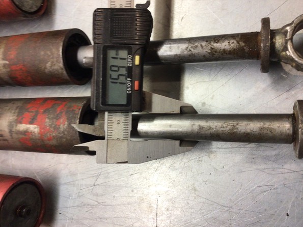

the original shaft size is 12.44mm on these. If yours measure 16mm that means someone has changed them. 16mm is far to big in this shock though. The bodies are small and oil capacity is reduced even more with 16mm. Also its been proven that twin shocks with 16mm shafts have too much sticktion.
Yes i can help with some info i have already but in the next month or2 i should also have the factory parts list for these shocks. As of 2023 there is/was no Service manual for these shocks. At best i will be able to come up with list/dimensions of parts and hopefully some spec sheets for some apps, but this info is hard to come by. Only people who have it are old WP dealers pre 1985 who are still around and not binned the info. WP/KTM do not have info. They all got binned years ago before the move in 2009. i already asked them. These shocks were already obsolete in 1984. I do know the o-ring sizes, but since your shocks have already been modified, who knows how much original parts are still WP anyway.
I am not sure how much the original info would help you though as yours already have been converted and have non WP shafts and seal heads and who knows what other mods and changes been done. I could explain how to work on an original set but it would not mean anything to you since yours have been modified now. I can see you have removed a c-clip already. I would just pull on the shaft and see what happens. The seal head should pop out. Original WP never used a c-clip like that. I wonder if your whole shock bodies have been changed? Original size is 31.75mm on the ID and 35mm on the outside and they dont have that ring in the middle of the body that yours have.
the best and most easiest solution for these shocks is normally to swap from 12.44mm shafts to 12.00mm ones and then use modified Ohlins twinshock seal heads and fit Ohlins shafts or custom made 12.00 shafts. Its a fairly straight forward job for anyone with lathe skills. Thats what most people do as it can be tricky to find the seals for the 12.44mm set up, plus its a multi piece sandwiched seal head which were never really any good and very hard to disassemble. The original parts are available but they have to come from a seal shop usually. I have not checked latest status on availability of parts from KTM. As of last year you could still buy the seals from KTM. The oil seal is infact the same as Ohlins anyway and can be ordered from a seal place. They use 12mm stepseal on 12.44mm shaft and the wiper/dust seal is 12.7mm, it seems hard to believe but its true! The DU bush WP used from 1983> for 12.44mm was a 12.50mm size. Suspension places do have this size as KYB/SHOWA use it. The reason WP used such and odd combination of parts is because they were sourcing the 12.44mm shafts from a car shock manufacturer in UK when they started in 1977.

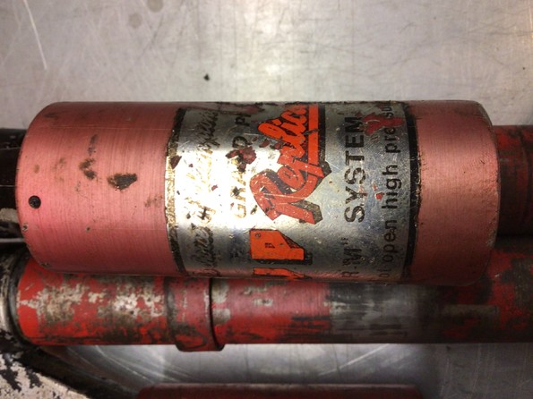

1983 was the last year for this style WP twin. Late 1983 the newer WP came out with 36mm ID body (same as Ohlins were using). The Sticker that says 'RM System' means 'Reverse membrane' which means the bladder is on the oil side not gas side like a KYB/Showa. Bladders of course are long gone but you can easily convert to 42mm floating piston which can be bought from KTM still as KTM 50/65 shocks still used these piston up to a few years ago or possibly still current. So that part is no great drama. The reservoirs are hard to remove. they are not screwed on. they are press fit with c-clip. You need a compressor jig set up in your vise to compress the reservoir so that the c-clip can be removed. Its a very hard job. I will see if i have a photo.

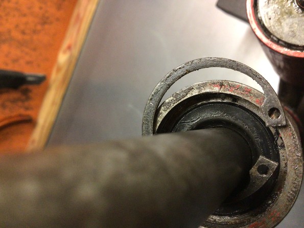

One thing i strongly recommend you don't use, is pipe wrench or vise grips to unscrew the bodies from the aluminium castings. it will ruin them! Use the proper tools. if the bodies are original still (35mm OD) then you can use 35mm clip on handle bar just off ebay. they are cheap. These are what i use https://www.ebay.com/itm/261599443704 Also you need heat from oxy acetylene torch on the threads but not too much. it is also easy to strip out the threads on these if you don't know what you are doing. they need heat but not too much heat and also need penetrating oil. Its a risky job because these shocks are all so old and never been apart and very tight/seized up. You need good skill, knowledge and ability to 'feel' whats going on.
*One last note. Your calipers say 15.91mm so i wonder if shafts are actually 5/8" (15.875mm) and not 16.00mm.

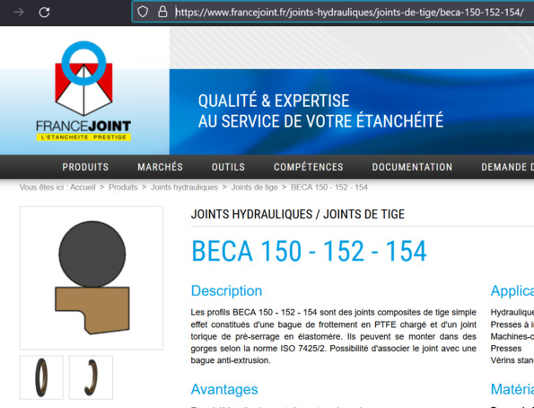

Nice to know that link thanks. I have found that the oil seal appears to me the same size as Ohlins. Even though WP has 12.43mm shafts, They seem to use 12mm seal stretched over the shaft. The dust seal in the cap is made by Eriks in Netherlands. The size is 12.7x18x3-4.5 and there is a small o-ring above it to pull the 12.70mm lip in to fit 12.43mm. The o-ring is N.B.R. 14.1 x 1.6.Swoum_55 a écrit :Les joints se trouvent en industriel.
Joint de tige https://www.francejoint.fr/joints-hydra ... 0-152-154/
[img_citation]http://www.srcf.fr/forum/img_forum/2021 ... ca-151.PNG[/img_citation]
I dont know why WP used all these odd combination of sizes. Even for later 1980's they used 12.5mm DU Bush Wim Peters told me they sourced the shafts from car suspension maker in UK and thats why they went with 12.43mm
Its a bit of a pain to fix and get parts for these shocks but i am designing a new conversion option to use 12.50mm shafts and modified KYB 12.5X36mm seal heads for KX80. It should work out a good way yo repair these shocks but its good to be able to fix them and keep the 12.43mm shafts if they are still good too. Ofcourse there's issues with bladders but they can be swapped for pistons and use 32x5 o-ring. This is what WP did them selves anyway. I am going to improve the reservoir attachment because they are not very well supported and they can tilt/lean in and scrape the spring.
Ravi de connaître ce lien merci. J'ai constaté que le joint d'huile me parait de la même taille que celui d'Ohlins. Même si WP a des arbres de 12,43 mm, ils semblent utiliser un joint de 12 mm tendu sur l'arbre. Le joint anti-poussière du capuchon est fabriqué par Eriks aux Pays-Bas. La taille est de 12,7x18x3-4,5 et il y a un petit joint torique au-dessus pour tirer la lèvre de 12,70 mm pour s'adapter à 12,43 mm. Le joint torique est en N.B.R. 14,1 x 1,6.
Je ne sais pas pourquoi WP a utilisé toutes ces étranges combinaisons de tailles. Même pour la fin des années 1980, ils ont utilisé 12,5 mm DU Bush Wim Peters m'a dit qu'ils avaient acheté les arbres auprès d'un fabricant de suspensions de voiture au Royaume-Uni et c'est pourquoi ils ont opté pour 12,43 mm.
C'est un peu pénible à réparer et à obtenir des pièces pour ces amortisseurs, mais je conçois une nouvelle option de conversion pour utiliser des arbres de 12,50 mm et des têtes d'étanchéité KYB 12,5X36 mm modifiées pour KX80. Cela devrait fonctionner comme un bon moyen de réparer ces amortisseurs, mais c'est bien de pouvoir les réparer et de conserver les axes de 12,43 mm s'ils sont toujours bons aussi. Bien sûr, il y a des problèmes avec les vessies, mais elles peuvent être échangées contre des pistons et utiliser un joint torique 32x5. C'est ce que WP a fait eux-mêmes de toute façon. Je vais améliorer la fixation du réservoir car ils ne sont pas très bien soutenus et ils peuvent basculer/se pencher et gratter le ressort.
