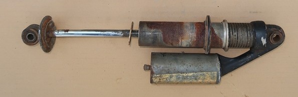

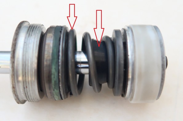

Yes i have heard of 'ohlins conversion' however i dont know the exact details of what people are doing. Some say ohlins internals 'just fit right in' well, no i have measured the seal heads up and checked the positioning of things and they simply do not fit without lots of major mods. probably new screw in body cap and or new steel body tubes. And no one has said if they are keeping the corte & cosso top out rubber and or rebound spring or eliminating both and use the Ohlins flat top out rubber, if so how are they retaining it? Loose on the shaft or machining in extra groove for wire clip like ohlins or perhaps making a carrier for it like White Power. one thing is for sure i wont be using 11.50mm shafts.
Yes i hate silentblocks at least on both mounts. I will be fitting spherical bearings for sure.
By the way, as long as they are 25mm, then yes you can get silent blocks that size, but i have not measured them preciscly yet. Both mine were beyond use anyway so not point saving them. I only have 1 shock at the moment but i got another one coming and hopefully more so i will have enough matching parts. Its early days as i have only had it for 2 weeks, and this is my first Corte & Cosso. Normally i only deal with WP, Ohlins, Fox.
I have a whole shed full of springs so i am not too worried there. This Corte & Cosso came with Hulco springs on it anyway because the person was running 1 Hulco and one Corte & Cosso. Yes 2 different shocks in different lengths. It explains why things were so damaged, eg bent shafts. Theres some stupid people out there thats for sure.
I think i have read all the threads on the forum about Corte & Cossos now but i will keep scratching around for info.

I wish you a good renovation:
https://www.srcf.fr/forum/t9330-Amortis ... osso..html
Although all Corte & Cosso parts are readily available from "Hugo" and in particular the 11.5mm rods, those supplied by "Hugo" are not as solid repairs as the originals.
This problem can be circumvented by using an Ohlins repair kit for 12mm rods and by recovering rods from used car shock absorbers.
Just put them at the right side and the thickness of the chrome of the rod will be more efficient...
Avoid damaging the silent blocks, they cannot be found or replace them with more luxurious ball joints.
Otherwise besides the fact that these shock absorbers rust easily, the Achilles' heel is the poor quality of the original springs which slacken over time.
Good renovation.
Greetings to all our Australian friends and enthusiasts.

Well, when i take piston apart i will post photo of the shims and we can see how it varies compared to Maico, GP MX, Sand, Enduro. I think somewhere out there, especially in Italy, someone will know more about Corte & Cossos. In Australia, there's not really any 'expert' knowledge or info on them. Thanks

Yes i did that last week but he said the codes mean nothing, even though i knew some ment GP MX, Enduro, Sand. I am thinking mine is from a Villa, Gillera, TM, Cagiva or something because Maico are 385mm

Yes i already knew these codes (from 81 Maico manual) but i cant find 8L and 4T :(
The shock is around 400-106mm long
Modifié en dernier par Cyclone82 le 29 janv. 2023 13:01, modifié 1 fois.

Hi, Can anyone tell me what these codes on Corte & Cosso piggybacks are for? I know its the type of damping or maybe model fitment? Thanks
Salve, qualcuno sa dirmi a cosa servono questi codici sui piggyback Corte & Cosso? So che è il tipo di smorzamento o forse il montaggio del modello? Grazie
Salut, Quelqu'un peut-il me dire à quoi servent ces codes sur les ferroutages Corte & Cosso ? Je sais que c'est le type d'amortissement ou peut-être le montage du modèle ? Merci
3T -
8L -
