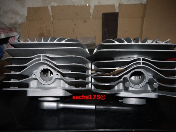

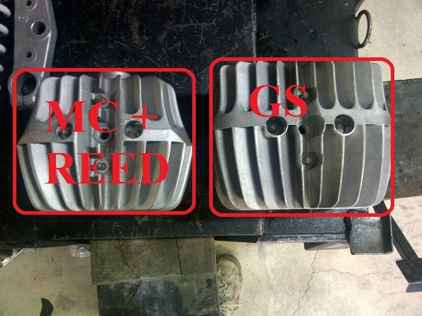

Ok ! As first we have to explain what is an SACHS GS-Cylinder (Geländesport) and what is a MC-Cylinder (Motocross) ?
For explainig it i have to use Super_riri16 picture, that is perfect for it . Watch the form of the cylinders !
The MC-Cylinder is a small one and the GS-Cylinder is a bigger one .
The MC- and REED-Cylinder has a 50mm ( outside diameter !) carburator connector for carburators 34mm up .
The GS-Cylinder has a 40mm ( outside diameter !) carburator connector for max 32mm carburators .
Yes i know some big Japanese and Italian carbs use 40mm..... . Thats right, but what's with the inner diameter of the connector ??? The wall of the cylinder material isn't thick enough all the time to machine them out to the carburator specs . :clin:
OK . Back to the picture : the MC_cylinder has the same form and dimension as the Reed-Cylinder . Please see my pictures.
on the left: MC-Cylinder / on the right REED-Cylinder

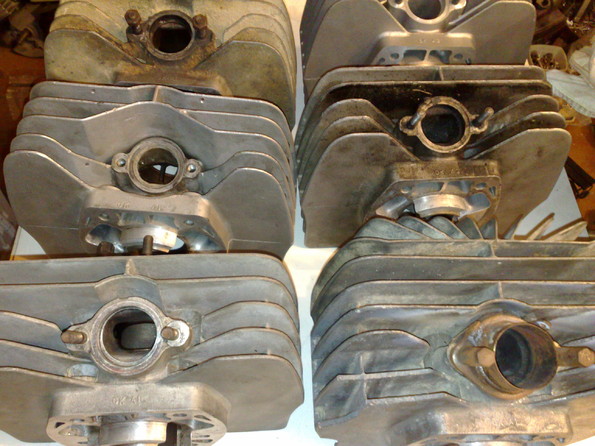

PART 1
And now : ports or no ports .
Maybe the ports are to big, so don't worry. As first put on the cylinder and let it run. Check it if something different to the former times . Will it go better or not . Does the power change to lower rpms or higher ? If the power is less than you have to change the carburator to a bigger one and that means you need a new connector.

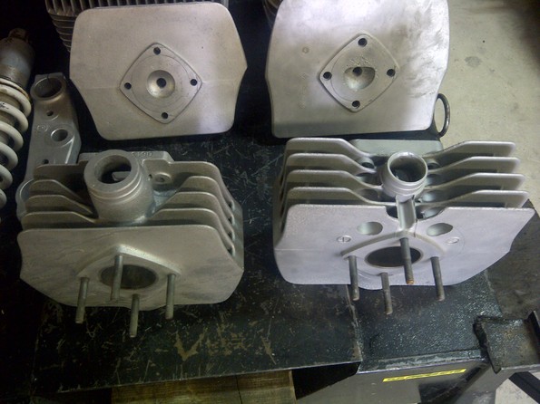

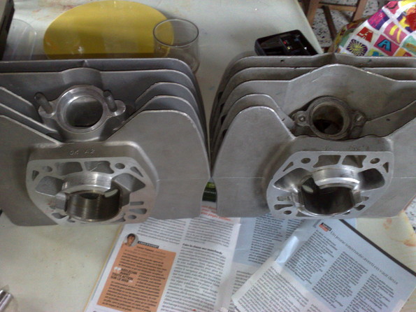

je suis allé trop loin dans ma préparation pour les transferts? plus assez de précompression?
à gauche cylindre neuf origine à "booster"à l'échappement, à droite cylindre préparé.
si je comprend bien à gauche c'est un cylindre GS et à droite MC ?
Hallo Thierry fürchtet zu weit in der "Friesierung " des Zylinders von rechte Seite gegangen zu sein , er fürchtet nicht mehr Vordruck genug zu haben
Am linke Seite ist es ein Originaler Zylinder mit "booster " ( zusätzliche Auspufffenster), am recht sein friesierter Zylinder.
Er möchte wissen ob rechts ein MC Zylinder ist und links ein GS modell .

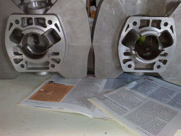

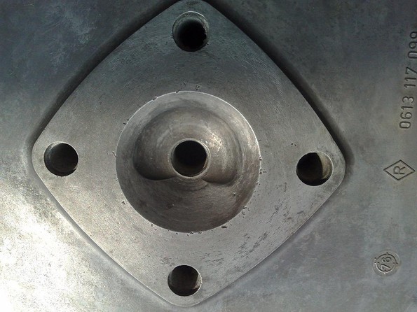

No my cylinders are not for sale.
Your cylinder head was machined out for changing the compresson ratio and to get a better velocity. But your combustion chamber isn't plain enough to do his work. That was one of the last methods from the Sachs Motorsport Department to find some power at the 125ccm models also. To use that chamber you have to machine all ports and you must change the carburator to a bigger one.

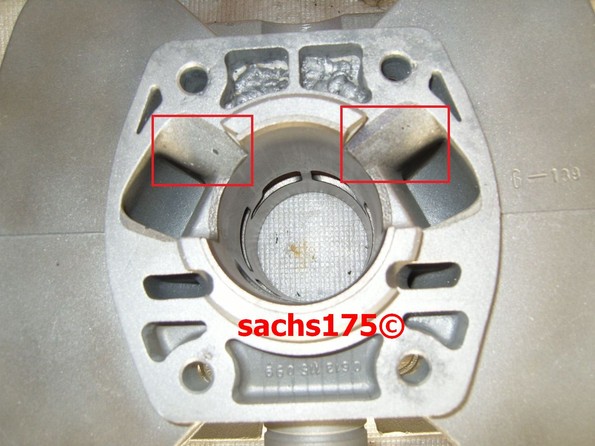

Here's a example: Factory (works) 125cylinder with welded transferports (see red frames) . Now they are smaler and so the precompaction will raise .

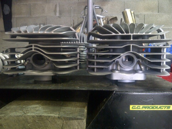

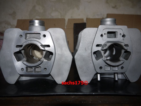

@Super_riri16
The right cylinder is the last evolution of the GS-Cylinders: wide exaust port with noses r + l and a bridge in the midddle of the exhaust-port. The timing goes a little bit in direction of the 125 MC-Cylinder, but the GS-Cylinder is only good for high revolutions. Allrigth this one has a little bit more power than the GS evo steps before but it's not so impressive. The real 125 MC-Cylinder which looks far like a Reed-Cylinder, runs great. The 125 Reed-Cylinder too.
Ahhhhh ! I forgot ! You can't mount the GS-Cylinder to the reed engine housing with out special works !!!!!!!!!!!!! The same has to be done for mounting the MC-Cylinder

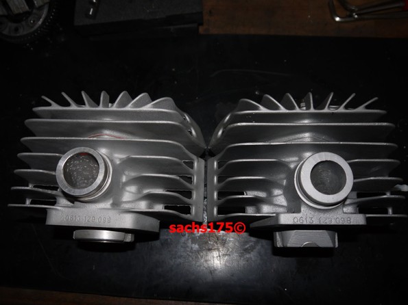

Left: MC Cylinder / Right: Reed Cylinder

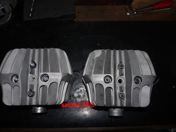

Intéressant, il y a aussi les culasses "ronde" et " chapeau de gendarme".

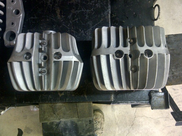

Bonjour à tous
Ce weekend ca été l'occasion de récupérer mon cylindre microbillé. ooooh! Il est tout beau......
bon maintenant direction au réalésage pour pouvoir faire rentrer le 54,25
J'en ai profité pour m'amuser à le comparer avec un autre cylindre de sachs 1252. C'est celui qui est monté sur une hercules de 78.
Je savais qu'il y avait les différances avec les clapets sur celui de la Nauder, mais je pensais que le volume extérieur était identique .... et bien que nenni. :hehe:
Le mien parait tout rikiki. Les ailettes sont plus courtes et taillées différemment vers l'arrière.
Je vous glisses les photos. le 1252/7AM n'a pas été qu'une simple évolution du 1252/7A.
Je me demande si sur la 250 il y a aussi cette différance extérieur sur le volume.
A bientôt
