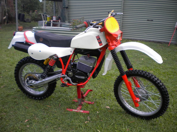

A white OEM headlight would be appreciated...Good Job and congratulations :)
A pic made at a flea market in Italy, in order to show you as it could be

You should change the headmask i think.
Yes, I think you are right.
Thanks Martin.

Good job, congratulations! You should change the headmask i think.

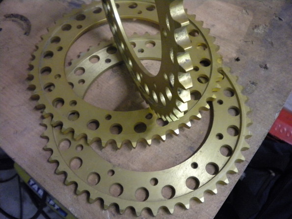

What color did you choose for the frame?
The color was matched by the paint shop.

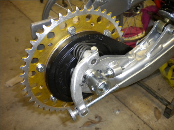

When I got the bike it came with a box of spares, in the box was 5 47T sprockets but they were for the bigger SWMs so they were 525 or 530 :quoi:.
[img_citation]http://www.srcf.fr/forum/img_forum/2011/02/097.JPG[/img_citation]
I have had one turned down to fit a 520 chain,
[img_citation]http://www.srcf.fr/forum/img_forum/2011/02/090.JPG[/img_citation]

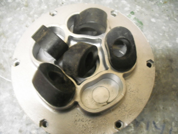

Do you put grease on the drive rubbers If yes what type? I got 52 of these with the bike :D
[img_citation]http://www.srcf.fr/forum/img_forum/2011/02/157.JPG[/img_citation]
Non, pas de graisse sur les caoutchouc, surtout pas de graisse de base pétrolière. Les caoutchouc ne vont pas supporter.
La graisse risque de s'amalgamer avec la poussière et se transformer en pâte à roder.

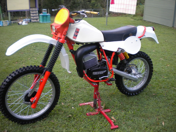

Very good job Noël! What color did you choose for the frame?

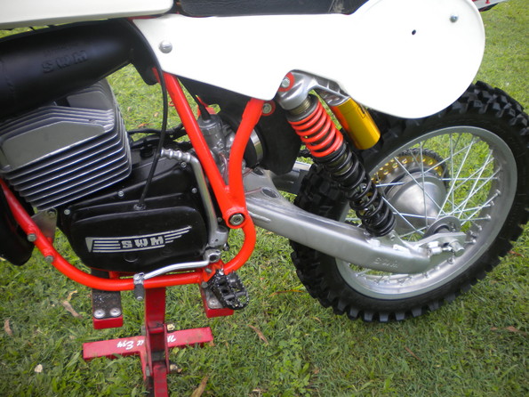

My rebuilds still going.
I have had the alloy hydrablasted and the spokes and bolts plated.
NOS chain guide and new plates.
I have given the shocks an upgrade.
Cheers
