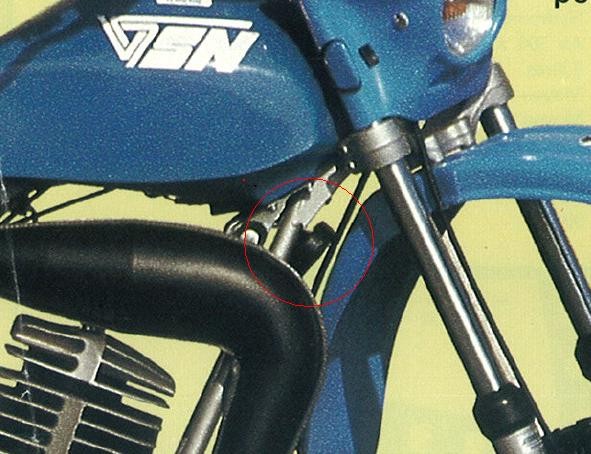

Je rencontre une énigme sur la fixation de l'avertisseur (un transval TR8) sur le cadre.
Dans l'exemple il est fixé sur je ne sais pas sur quoi au départ du double berceau sous la colonne de direction. Ce cadre est celui de la première génération. Je pense qu'il devait y avoir un support , comme j'ai été dans l'obligation de changer de carde par un 83 renforcé il y a quelques années, je n'ai aucune idée du comment il est fixé. Si l'un d'entre vous à une photo , une information ....... SN125 as tu un avertisseur sur ta SN ? comment est il fixé ? si en plus tu avais une photo ce serait top .Même question pour toi Sachs175.
Well, I appeal to connoisseurs of SN.
I met an enigma on fixing the horn (a TR8 Transvaal) on the frame.
In the example it is fixed I do not know what initially double cradle under the steering column. This framework is the first generation. I think that there should be a support, as I was obliged to change cards a few years ago reinforced 83, I have no idea how it is attached. If one of you in a photo, information ....... SN125 you have an alarm on your SN? how is it fixed? if in addition you had a picture that would be great. Same question for you Sachs175.

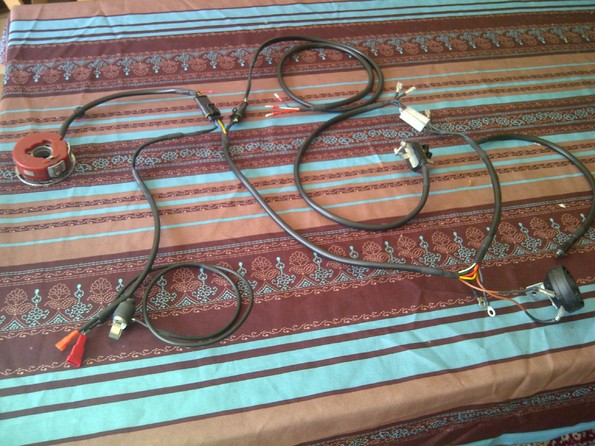

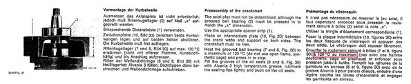

Yes Tom, they were heated, but not very strong. I talk with my friend who helped me assemble the engine. I have every confidence in him. For the type of bearing I would see the model that has been mounted. FYI the photo is just for the break, but there was no heater directly on the crankshaft. :hehe:sachs175 a écrit ::hein: :hein: :hein: :hein: :hein: :hein: :hein: :hein: :hein: :hein:Super_riri16 a écrit :Bonjour
[img_citation]http://www.srcf.fr/forum/img_forum/2013 ... -00067.jpg[/img_citation]
Riri.
Is that right? You did heat up the crankshaft bearings ? That's the best way to kill them . I know , the workshop manual said you have to heat up the bearings to temperature of 130°C , but that's bullsh*t and nonsens ! If you have the right bearings, so they will have a cage made out of polyamide and that cage will melt or it will warp and that means the bearing is heavenly damaged . The correct way is to put the crankshaft into a freezer and cool it down at a temperature of -15°C or deeper for 8 to 12 hours . Than you can mount the bearings by using a aluminum punch (it looks like a one side closed bushing) and a hammer . Do smoothly punches . That's it . :clin:
The harness looks great !!! Good work , dude !!!!!
Thank you for this advice, which will be useful for the next time.
Regards
Oui Tom , ils ont été chauffés, mais pas tres fort. j'en parlerais avec mon ami qui m'aide à assembler le moteur. J'ai toute confiance en lui. Pour le type de roulement je verrais le model qui a été monté. Pour info la photo est juste pour la pause , mais il n'y a pas eu de chauffe directement sur le vilbrequin. :hehe:
Merci pour ce conseil , qui sera utile pour les prochaines fois.
Amicalement
Riri

GAUTHIERBMX a écrit :tres bon travail
mais refaire un faisceau avec un sweat hva c est prendre le risque que ta magnifique nauder ne demarre pas......................... :clin:
jean
Mais non Jean
merci pour ton encouragement
A+ riri
Riri.
Best greetings
Tom
