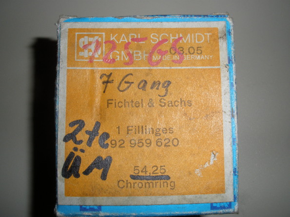

Pistons with marks like : A,B,C,D,E,F .... or what ever are no pistons for Sachs 7speed engines !!! 7speed pistons allways show the piston diameter or in earlier versions the bore size which they fit . You can find this notice on top of the piston, sample: 53.731 .
Riri again : you have to use only forged pistons in 7speed engines. Use original KS pistons or if you can get : Asso pistons . This stuff will work . Goal or similar manufacturers will not working and will bring you in trouble . :clin:
Cylinder with bushing:
To get the right gap between piston and bore : as first the bore has to be bore out and then the last 2/mm to 3/100mm, to fit the bore size, has to be honed ! Thats the corect way to fit a cylinder .
Cylinder with coating:
To get the right gap between piston and bore : as first the coating will to be removed . Then the new coating will be apply to the cylinder bore . The cylinder bore size diameter is now smaler than the piston . Now the coating gets removed by honing the cylinder bore to the specs it needs .
